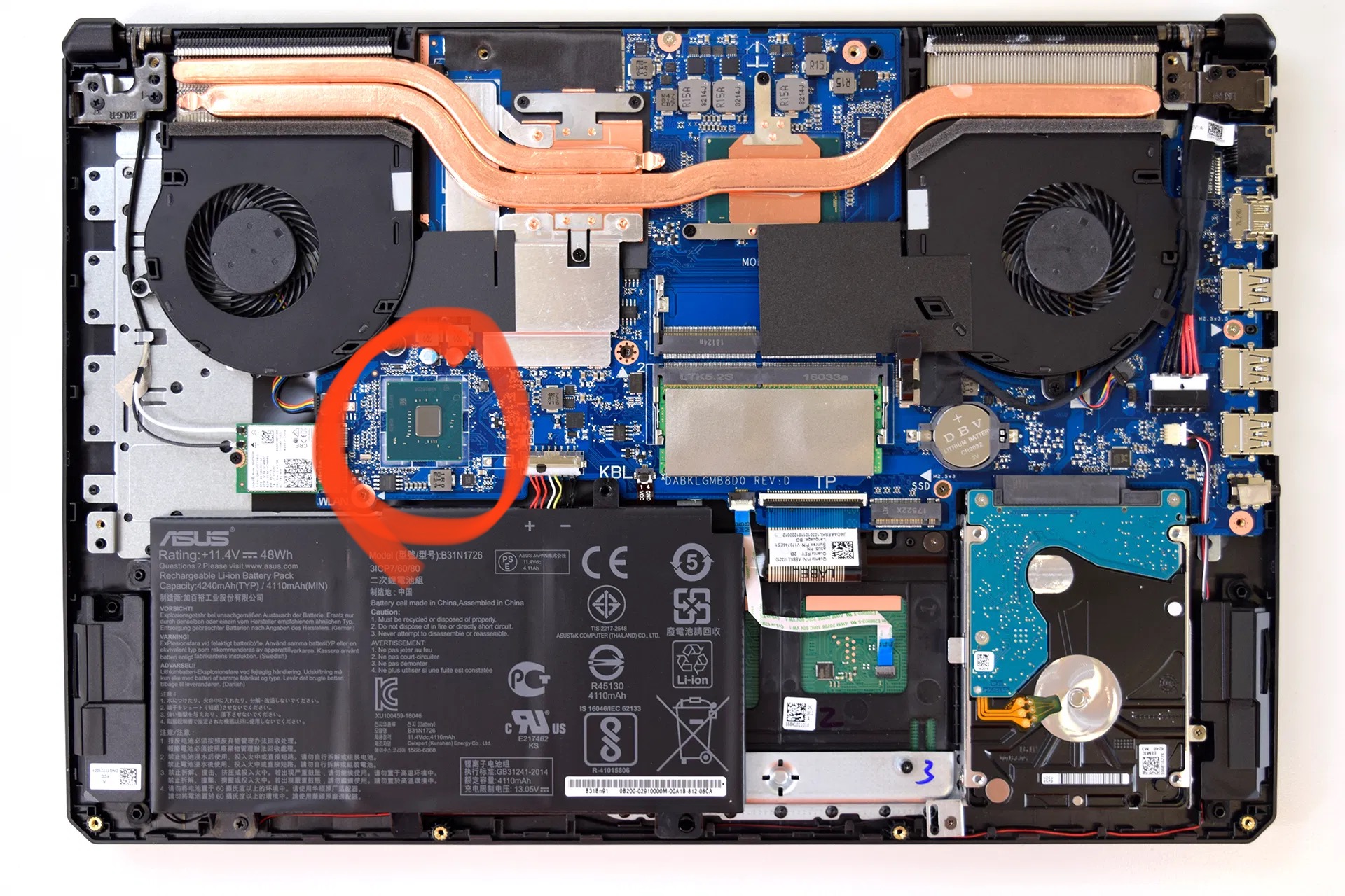

I have got an ASUS TUF 504GM. i78750h. Nvidia 1060. 2x8 gb ram. Thermal paste replaced. I do not have the last BIOS because it locks the most important functions of TS. All windows cpu and gpu drivers up to date. Software working from SSD and some sceneries installed on HDD. Windows 10 Home.
Played a takeoff and landing, during takeoff roll and the last 30 secs before landing I have got the highest fps drops to around 16-18.
If I rise the CPU frequency I will get worse temps.
For sure you know more than me, but even when using a "smaller aircraft" which means less gauges and less cpu and gpu heavy, even if temps are lower i get that frequency going down to 3000 or 2800 for no visible reason

Are you running any Asus CPU control or fan control software on your computer? In the Control Panel Power Options, what Windows power plan are you using? Is it some special Asus power plan? Try using the new ThrottleStop feature that lets you switch to the default Windows High Performance power plan.
The log file clearly shows what is going on. In the far right column you will see PL2 on a regular basis. This means the reason for throttling is the short term turbo power limit. You have this set to 55W in ThrottleStop which is appropriate. What most people do not realize is that there are 3 unique sets of turbo power limits. Your laptop is ignoring the value that you have set in ThrottleStop and instead, it is setting its own internal PL2 limit to approximately 22W. You paid Asus for a 6 core - 45W CPU but they seem to think it is OK to only allow the CPU to access half of that power when gaming.
In other words, your Asus TUF laptop is not tough at all. If changing power plans and ditching any Asus control software does not fix this problem then there is not much you can do. If Asus programmed the EC to limit your CPU to 22W then that is all your CPU will get. Some manufacturers do crazy stuff like this whenever the GPU is being used such as when gaming.
Pretty sad when Asus creates a good looking laptop and then kneecaps it like this. You can contact Asus but since the warranty is probably up, they are not likely going to admit to what they have done let alone come up with a fix for this problem. I have always had good success with their desktop motherboards but I would be hesitant to buy or recommend one of their laptops.

I see what you mean. But in the past, just allowing the frequency to go higher I actually arrived to 45w and even 60w on a benchmark. I also felt now when using it for a while longer and getting more textures in the game (as storm clouds) that temps go pretty high. GPU around 82 and CPU around 85. BUT. I actually feel heath on the center of the laptop where GPU and GPU are not located. Could be my RAM or some other component overheating and causing issues?
By the way I do not have any ASUS software installed. Windows and TS on high performance mode.
Thanks
Was that benchmark using your Nvidia GPU? Something like Cinebench probably runs OK without severely power limit throttling the CPU. A user would be more likely to see what is going on and would complain. Cannot have that. Maybe Asus thought no one would notice a problem if they were busy playing a game.
What I see in the log file is that as soon as your Nvidia GPU becomes active and gets up to top speed, almost immediately, a signal is being sent to your CPU telling it to restrict the turbo power limit to approximately 22W. This caps performance so your CPU cannot run at its full rated speed. It continuously throttles so it does not exceed this power limit.

well. After checking other ways to solve this issue you mentioned, I came to an apparent solution (at least works for me pretty well in the meanwhile, did not read it anywhere).
What I did is, reduced the curve of the gpu on afterburner to around 1100 FLAT. Yes, 40% less of what it should offer me but still not decreasing performance. I was trying less and less and saw how gpu usage goes up every time and cpu usage and frequency stay more solid. Even passing 25w sometimes when needed.
On this way I can use the simulator with very decent graphic configuration and not more than 70% gpu usage, steady 25 FPS (almost not going down) which looks pretty real.
My only concern is a heat source around the L key, which looks to heat up more than the cpu. It’s apparently this little guy on top of battery. Do you know what is it or any solution for it?
