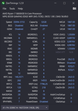

experts, do you think it makes sense to change the RAM from
3600 MHz (18-22-22) to 3600 MHz (14-14-14-34) ?
will it help to equalize the frame time?
You won't get that just with a tune, you'd need to swap the RAM to B die.
I plan to replace the RAM with such a "G.Skill TRIDENT Neo [F4-3600C14D-16GTZNA]" they are on B-die chips, and has an XMP profile of 3600 MHz (14-14-14-34).
Don't buy a 2x8 GB set. 2x16 GB will be faster and more appropriate for 2023.
Any 2x16 B die set will tune manually to 3800/14 with voltage. For example my own Dominator Platinum kit is 3200/14 stock, but I'm running 3933/14.

You guys are doing something wrong. Either wrong gear, geardown mode, 2T command, or something. 3600/14 should be in the region of 60ns.
3600/14 should not be higher latency than 3600/18.
https://github.com/integralfx/MemTestHelper/blob/oc-guide/DDR4 OC Guide.md
Don't change settings you don't understand.
These are my settings, but you'll need to up your DRAM voltage to be stable.
Warzone stutters with these RAM settings. It's not the RAM timings that are at fault...
