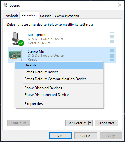

well thank you so much i have ALMOST everything done. i wasn't able to get the encoder always on with the command in RTK Panel.txt and couldn't find the files for the apo
Good I am happy -- "I wasn't able to get the encoder always on with the command in RTK Panel.txt" -- You got muddled up a little.
Enable 'Stereo Mix', mute the stream, then set it to play to SPDIF to keep the encoder always on.
https://ibb.co/477T74G | https://ibb.co/MVgzT5s
To see Stereo Mix in the recording tab, right click the white space under a device and tick 'show disabled'.
I can also see my S1220A policy has unlocked more samples, enjoy!

i was looking for the stereo mix on the playback tab instead of the record tab that was where i got lost thank you so much everything is fine now. it's almost a year since you helped me configure this and everything was working fine, i don´t know what fucked it up but your driver is the only thing that can make this old setup work. love your work and the constant updates. have a nice day

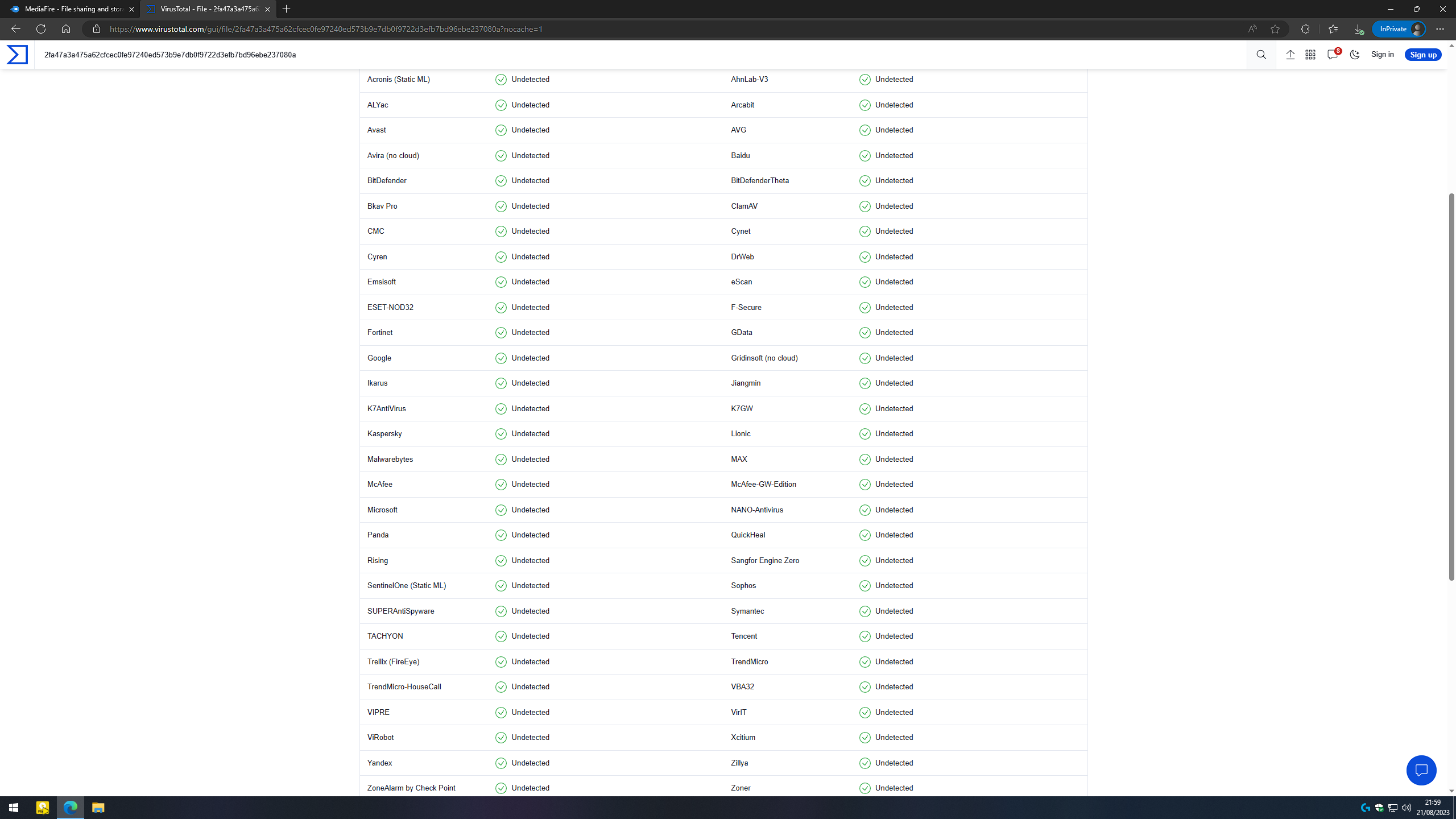

The package has been re-submitted and passes, with a two exceptions. They are false positives, so they can be ignored.
Install and FX Config shortcuts removed and replaced with standard boring looking bat files.
