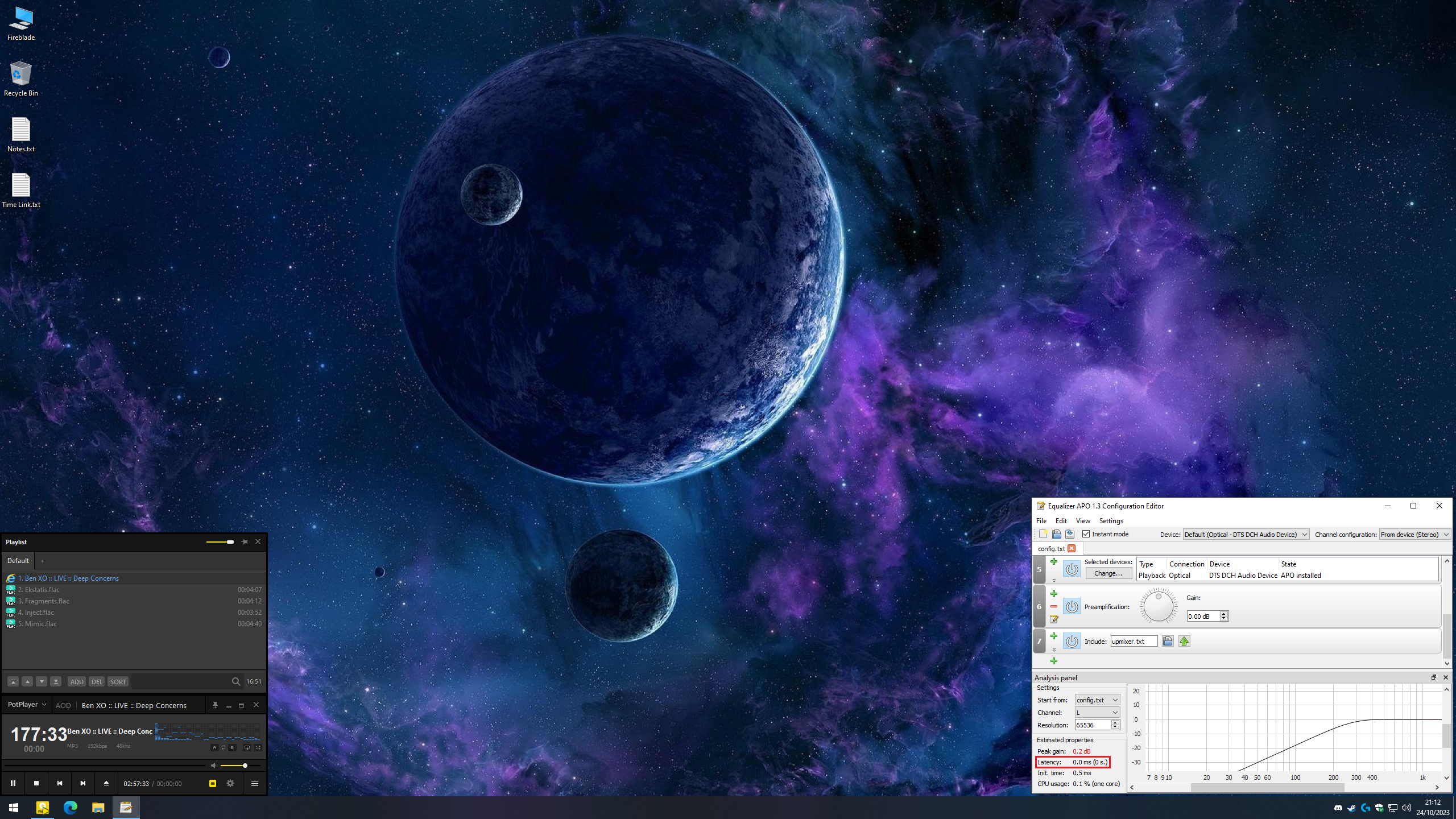

Note to all:
Imagine an app or audio file that is 24 bit in total, also imagine its using the maximum decibels 24 bit can digitally represent (around 144.5 dB).
Windows volume management seems to be after some APO points (SFX-MFX), meaning it wont stop digital clipping until then.
To make digital clipping impossible, and add an allowance for EQ's and other enhancers to work without clipping, we can use EAPO.
You can use my config and setup (here), disable (power off) the upmixer if you are using 2 channel (stereo).
Thankfully EAPO is setup at the SFX point and is the first APO (other than MS hidden APO's) to process audio. EQ's, other, are on MFX (after).
-14 dB should be enough for any enhancer. -4 to -8 dB is enough for most things.

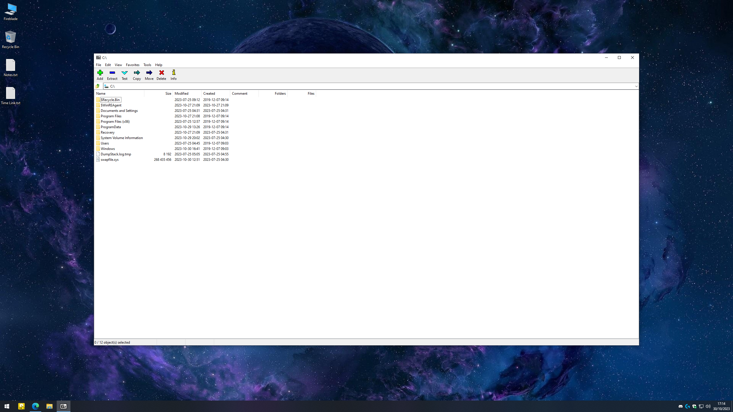

Here is an interesting bug, which I think is partly Windows and partly Realtek, although I am not sure because I restore Windows (testing, other).
I noticed yesterday in the partition backup of C drive (Windows only), there is a hidden 'RTHDASettings' folder.
After some investigation, it turns out the motherboard likely extracts data to the Windows partition for driver purposes.
What's in the folder? Where is it in Windows? I have an Asus board too mine uses the 1168 though. Asus locks their shit down. This folder could be the key to unlock it and allow stuff to work how we want instead of how they want.
I gave up on trying to get Windows to see HDMI as a different device other than how it processes it. Every api I try to use that is somewhat new reads it as headphones, trying to trick it through registry did nothing but steal my time lol. I would be happier getting it to somehow recognize height speakers to properly set up 5.1.2.
It's specially hidden, I would not even know about it, only because I opened the backup in 7-Zip and noticed it. I tied yesterday to locate it on the drive, its not possible, not even if I mount it.
It's hard to describe how this has been implemented, it's as if the partition has two data files, one is the actual partition, the other with OEM data in it.
Where you can only ever access or mount the main partition file as C:\, and can never directly mount the OEM data point.
Also my Asus S1220A + CS3 is a 1168 same as you. That won't solve HDMI that is driven by AMD-Nvidia-Other, and Windows doesn't support modern speaker configs such as 5.1.2.
Edit: I would also guess that a certain step takes place when the driver is installed, as endpoints are deleted and remade.
