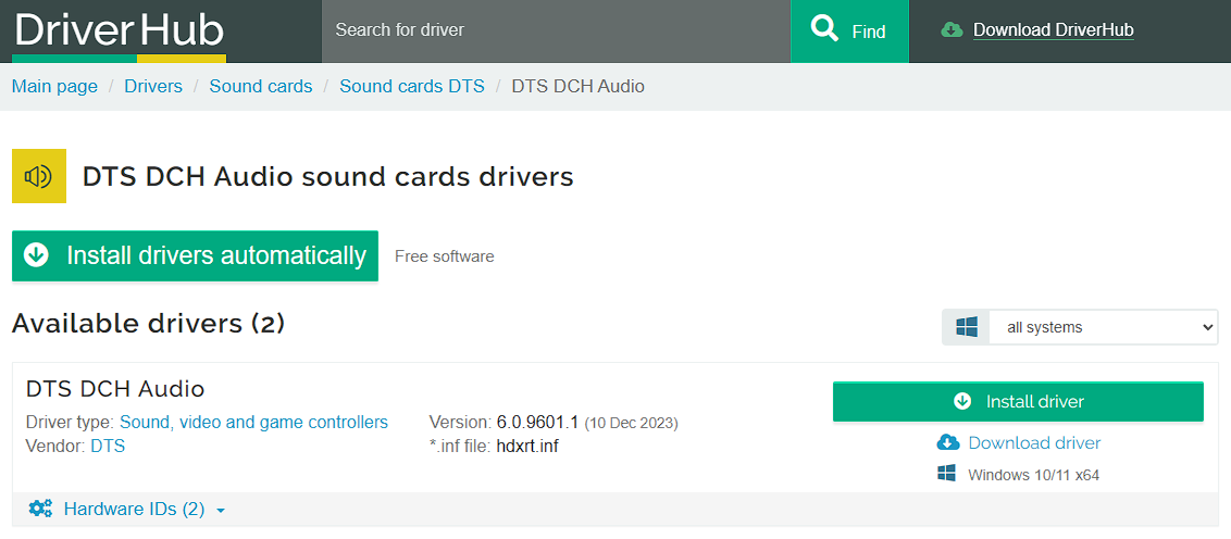

I was slightly amused when I saw this web page (image below) found on Google, still make sure you download the package from here (post 1).
Also, I noticed a hidden 'Microsoft Trusted Audio Device', or similar name, is added when the driver is installed (post 1).
Regardless, make sure you use the installer else you wont get the certificate.

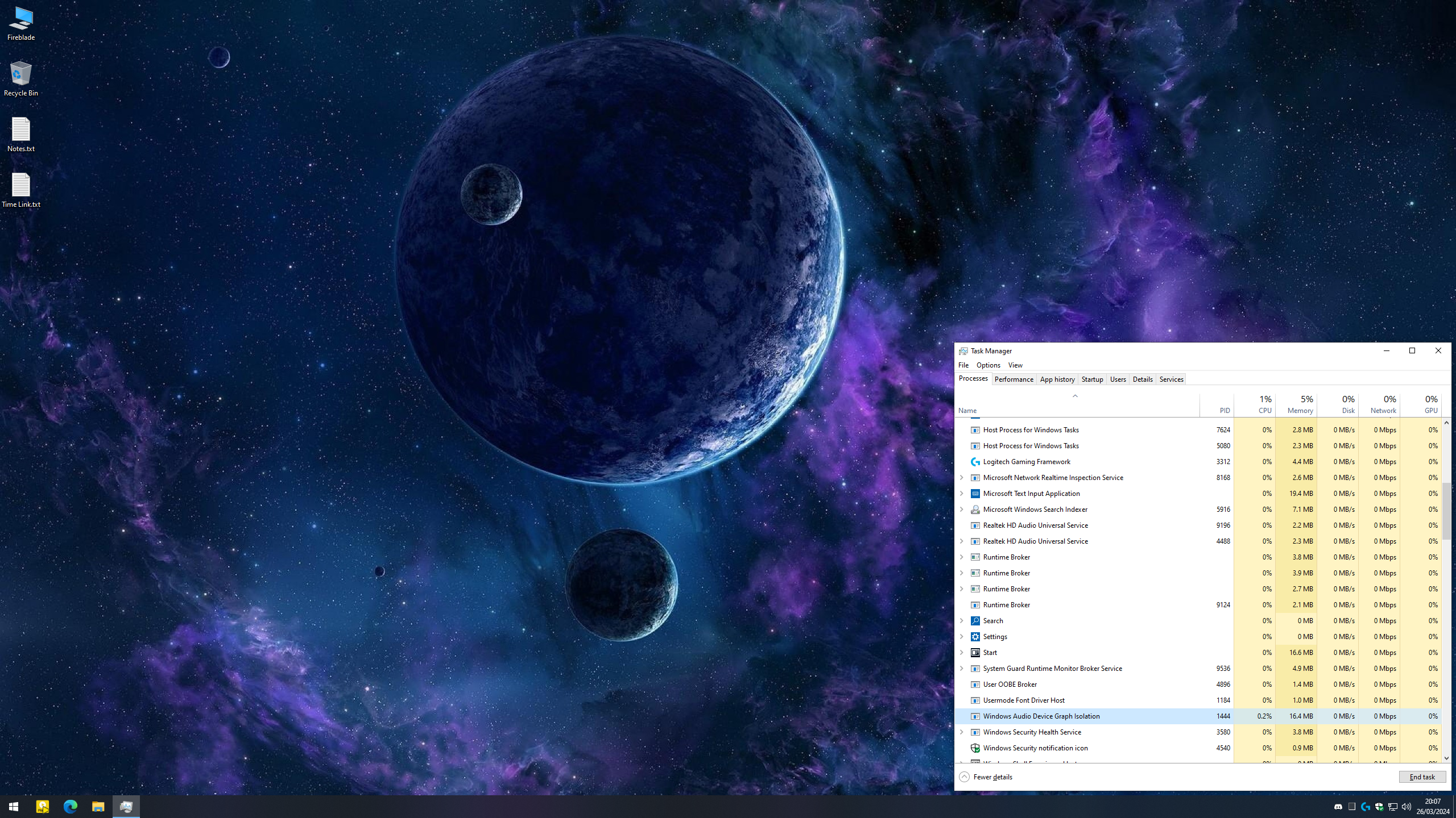

Just decided to do a quick DPC check with music playing (internet stream) and discord open (with gifs+other going on).
Dual desktop mode, the above is desktop 1.
Please note the driver does not use hardware offload, its all CPU-RAM based, essentially DMAS style.
