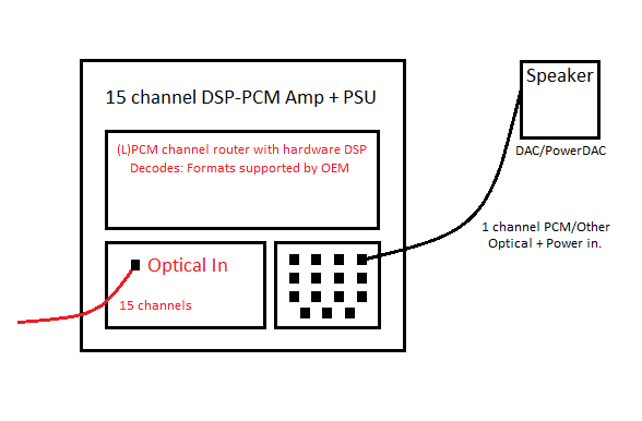

Some future tech:
Please note that a DMAS does not make DTS-Dolby redundant, instead more into PCM processors at the DSP point (external main unit, not software).
The compressed formats can-are used to bypass channel restrictions (such as Windows, 8 channel) and reduced bandwidth.
You can image the main unit of the DMAS as a PCM processor, with-without DTS-Dolby-Other PCM enhancements.
32 bit float should make volume management at the PCM level (without amp) more doable.
Note that while compressed audio formats decode to PCM, they passthrough PCM processors (not in PCM form, inside a container), until decoded.
Since the main unit is working at the input level (PCM), formats can be decoded as normal, then continue to processing as PCM.

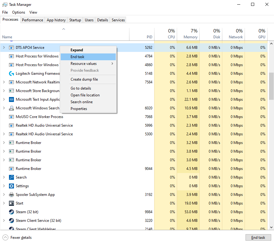

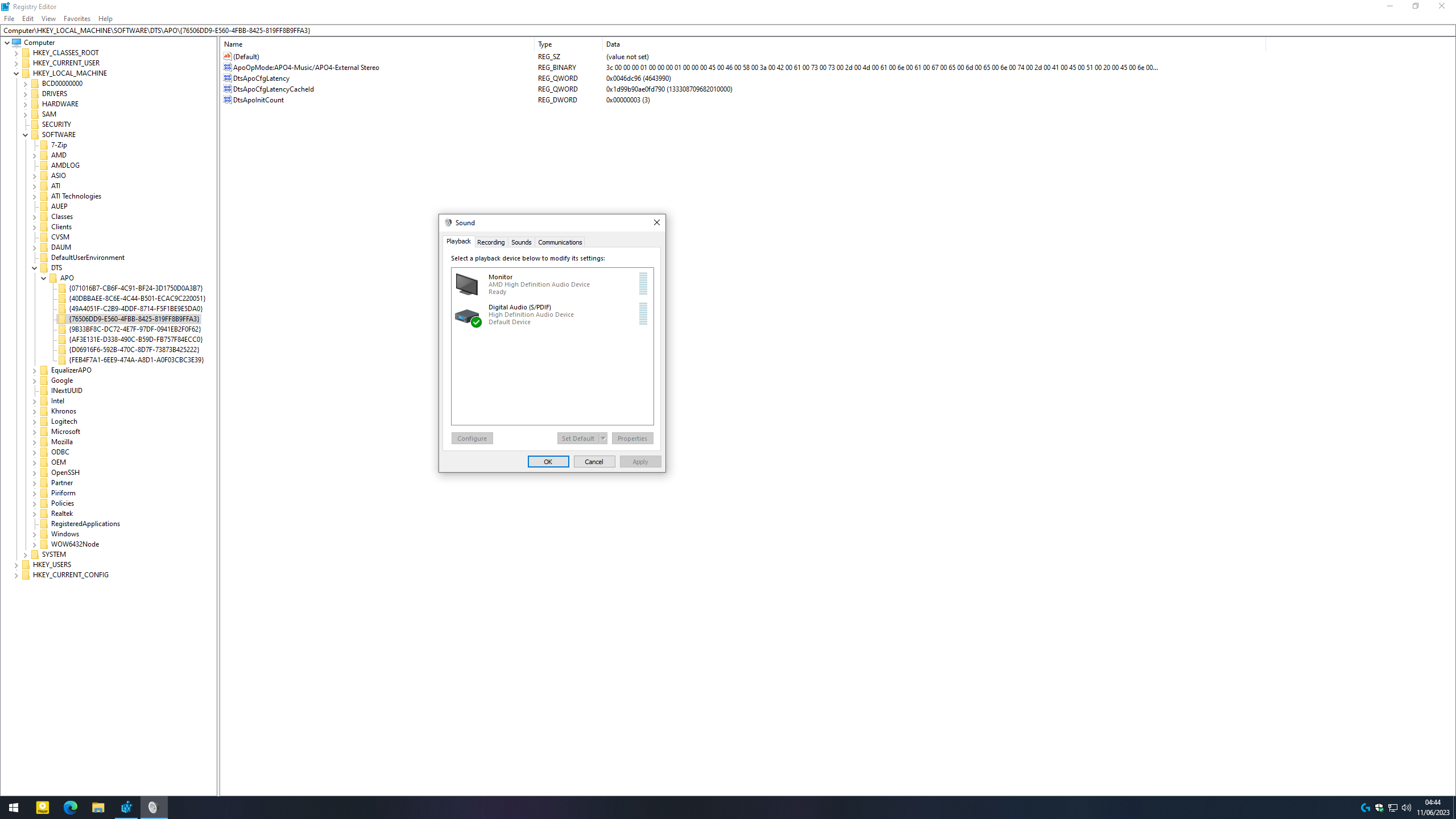

File installer updated. If you want to uninstall this pack:
1. Stop the DTS and Windows audio services via Task Manager, then delete: C:\Windows\System32\DTS\PC\APO4x\.
2. Open Regedit and find and delete: Computer\HKEY_LOCAL_MACHINE\SOFTWARE\DTS\.
3. Rebuild audio endpoints using FX Configurator (removes added keys).
You can also run a registry cleaner after, although entries will do nothing if left.
