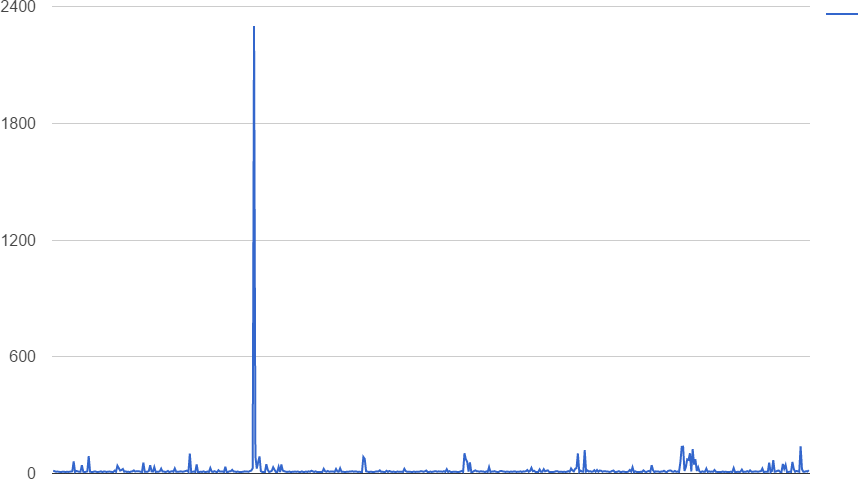

I've been thinking about mouse lag. The video really looks like mouse lag. I've experienced mouse lag. It's a thing.... all games, there's a constant somewhere.

The type of stutter you see in The Forest is common in UE games, I can basically recreate this by simply hovering over an icon in Squad, which also uses Unreal Engine.
Edit.
Source of this might be different depending on the game/scenario but this is how it can manifest.
I owe you a beer. Decided to switch my mouse from USB switch to direct connection to mobo. Guess what? USB disconnects whenever I saw random stutter in Squad:
After some cable dangling I could replicate this in desktop. RIP G400 (yeah I know, cable can be replaced).
So yeah, OP - one option might be verifying your input devices.
This however did not eliminate the stutter inherent to UE on displaying things like UI elements:
