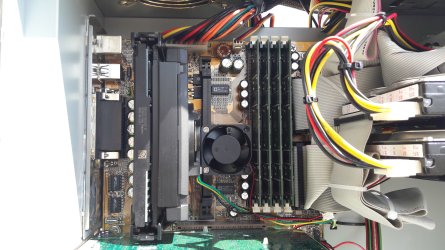

How is it going folks?
I miss the time when I had TIME to spare. :) I didn't post something for such a long time ...
I am still doing what I know to do best and that is finding and restoring relics of time gone by but never forgotten. :D
The number of parts that have entered my "collection" are too many to count and I also started offering complete systems that are made according with my client's requests. :D
The ATI episode is in the works.
More later.
