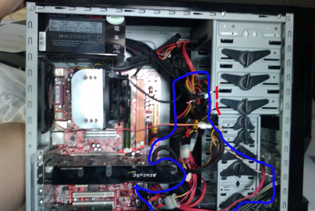

Who ever built that system and sold it should be shot. The cable management is horrible.

If you want to bring your temps down some more, work on that cable management. The way your cables are now may be hurting your airflow.
As I have show, this is the way air should move in your case. The blue arrow being cool fresh air being drawn in from the outside, the red arrows being where it is flowing hot air out of the case. See where all those cables are where the air is being drawn in? Try finding a way to manage them so they won't block as much airflow. :toast:
I'll try doing that, though these cables are really tight fitted by those apparently bad builders..

Okay, so you see those red lines? Cut those two zip ties. Next, try to route all cables in the blue area to the left side of the case. (The other side.) It should be fairly easy to do. If you need any more help with this, remember to post some photos as you go. They could be very helpful.
Oh, thank you very much, I am really overwhelmed about how much you guys help, and how fast, i'll unpluck the beast go for it and take some pic's (;
