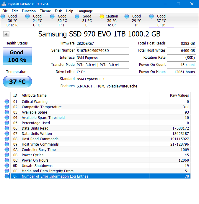

First the current status. 51 data and integrity errors. Also down to 93% spare.
So what has happened.
I had noticed a couple of months back erors had creeped up to the teens, but at the time no ill effects noticed.
Then I got my 3080FE, and it has no Win8 drivers so had to update my OS.
I proceeded to make backup of my system drive and also the second partition as I wanted to resize the OS partition larger, both of these on the 970 EVO.
Macrium failed to read data on the second partition, CRC read error again and again.
Each time the error popped up the medi aand data integrity error counter went up, and sometimes it also triggered the available spare to go down.
I then started running chkdsk /r as advised by macrium and this massively accelerated both stat changes but eventually the data became readable and I did the backup.
I then moved the ssd to ryzen rig, tried to beat it down with reads and writes, not a single SMART issue logged.
I didnt RMA to samsung as my experience with them has been poor (they seem incredibly strict, rejected previous RMA with 100s of CRC logged in smart), as with brexit would probably be huge shipping delays/costs as RMA centre not in UK.
I did some testing on main PC, reduced system agent voltage which fixed CRC errors on SATA ports, since I fixed that issue I became confident the problem was the NVME signalling rather than the drive, as it also was finein ryzen rig.
Since I have put back in this PC there has been no stat changes, and its been in here since mid February. So looks like was a system agent voltage been too high issue, but I have been checking it now and again.View attachment 194423

Quite the story. VCCSA and VCCIO can definitely cause stability issues, but this is the first time I see a possible relation to SSD errors. Very interesting that the drive ate 7% off the spare while not dropping a single percentage off the health %. I assume it replaced the bad cells from it.
