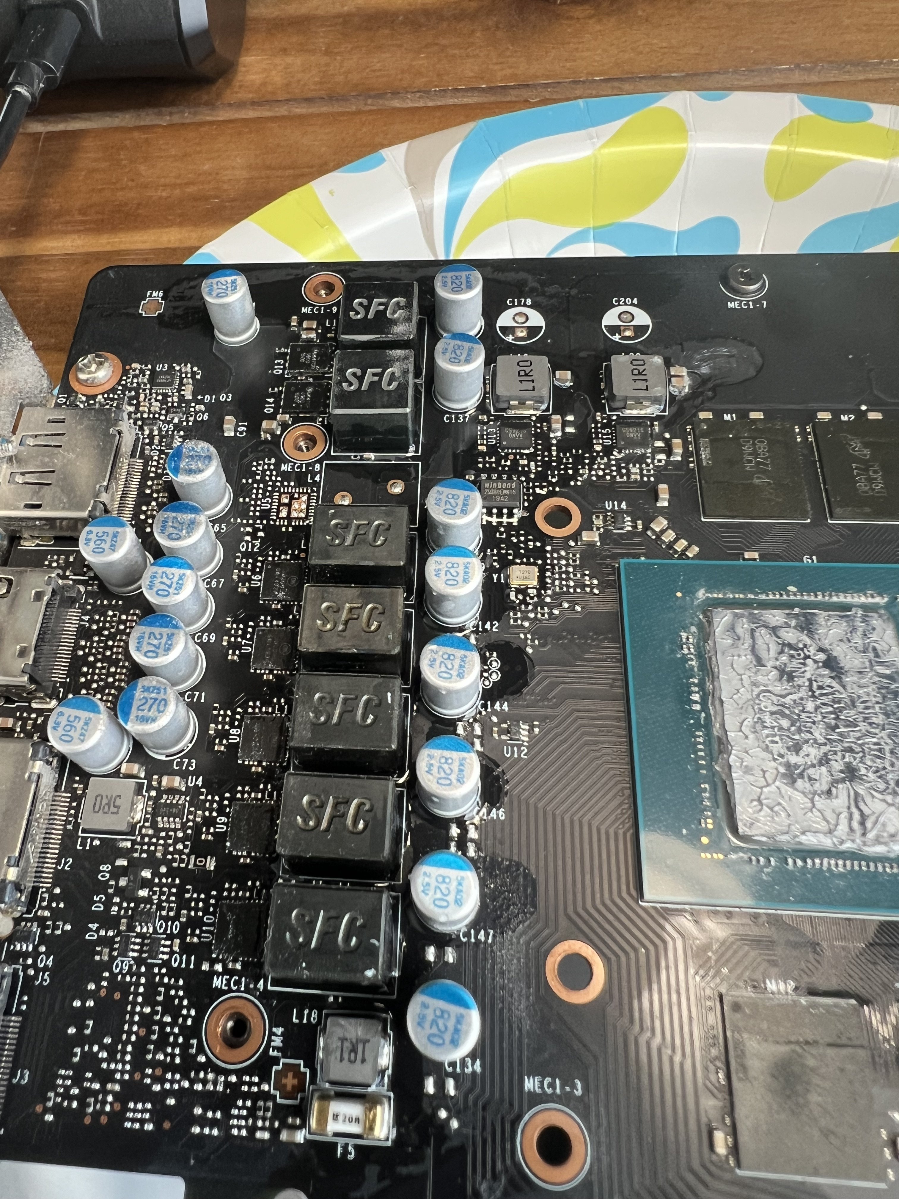

I have a MSI 2060 Super Ventus OC 8gb here with really bad whine/buzz coming from the area with the line of inductors that are to the left of the die. I used a metal straw and listened around the card when I had Elden Ring of WoW running, which is the only real offending program. Surprisingly neither furmark, prime95 or the combination of the two caused the sort of noise that comes up when I run Elden Ring or retail WoW.
Test your glue first!
I almost used the duro glue pictured here, and by testing it first I realized that it said GEL on the product, from which I just somehow did not see until I actually used some on a test object. Thankfully my local Aubuchon Hardware had several brands of super glue, of which the "liquid original super glue" super glue brand was found. I picked these little guys which came in a four pack, I ended up using one and 3/4" of them and I feel like I adequately soaked all the members that could cause potential noise.
Thanks @lexluthermiester for the suggestion of this material to use, it definitely climbs up and around the necessary parts of the card, so much so that I would say "wicking" is a understatement, liquid super glue is certainly the best real-world solution for DIYers especially. I only spent $2.69. Some time, and with slight eye irritation from working too closely without safety glasses I was able to perform the procedure successfully (I think.)
I cannot stress enough to do this procedure on a completely level surface. My apartment is very uneven, as the house was built in 1830s on the side of a river, the floor is sinking in and even with my most level surface in the house I did have significant run off that almost met the PCIE pins. Have cotton cutips ready. I had to jet to the bathroom pantry to keep it from getting out of hand.
It is definitely concerning that along the line of the inductors, it goes 2 of one kind, SFC with a shinier finish, then an empty spot for an inductor which probably would have helped with causing less whine?(I would also agree that Super models def get the shaft with mfg. quality) and another line of 5 SFC inductors that were of a darker shade. Perhaps only the caps were different, and the underlying part was the same. Either way, this definitely looks shoddy, and I assume that this was to save on manufacturing costs somehow. It is quite odd that this super 2060 8gb is almost opposite to all other 2060 card layouts I see on a google image search, its like all the inductors were placed on the opposite side. Most other 2060s seem to have their line of coils under the power connector, which makes more sense to me.
I'm letting it cure overnight and going to check out the level of success I have tomorrow afternoon. Probably going to cure at least 20 hours. Excited to see (and not hear) some results.
