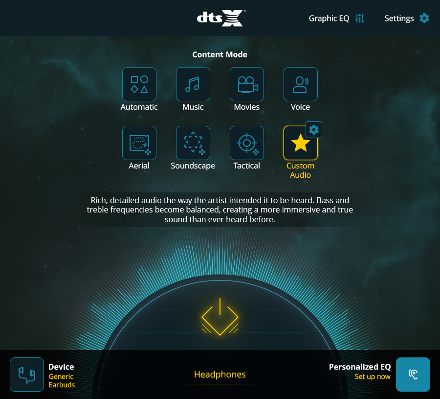

This is DTS Audio Processing (UWP App) will be released on unpublished Toshiba laptop.
I am try to making it to use for other unsupporting device, but DTS Audio Processing UWP stuck on "About DTS" interface.
This is DTS:X Master PC screenshot from here. The UI look like DTS Custom. There is no more information which laptop or motherboard will be bundled with DTS:X Master.
New DTS:X® Ultra 1.0 Technology has been applied on both DTS Audio Processing and DTS:X Master software on PC.
There is a also a software called DTS Tuning Tool used to create XML preset for different device on PC and Android.

Someone post a screenshot which shows Dolby Atmos for stereo speakers, DTS Headphone:X and DTS X Ultra spatial sound formats on flight 17713 (RS5).
https://answers.microsoft.com/en-us...-is-dtsx/950b1950-e20a-4a49-82c8-2ec2dc707513
I have found a DTS:X Ultra UWP app on Microsoft Store. I am not sure this app require DTS APO 4.x OR it is for DTS:X Ultra spatial sound format on Build 17713 (RS5).
https://www.microsoft.com/en-us/p/dts-x-ultra/9n0h1m8j1308?activetab=pivot:overviewtab
It cannot be downloaded and installed from Microsoft Store, like other DTS UWP apps. However, DTS:X Ultra UWP app provide both x86 and x64 arch builds. I upload x86 and x64 appx file on mediafire.
DTS:X Ultra UWP appx file x64
DTS:X Ultra UWP appx file x86
