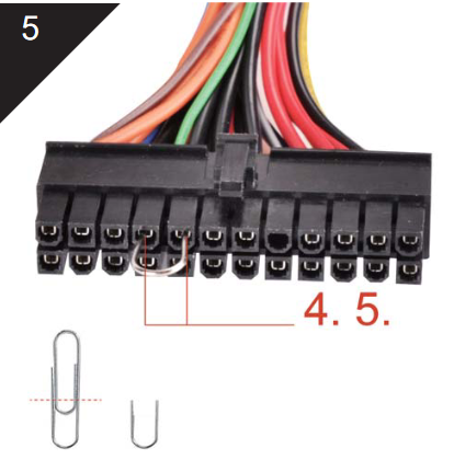

"Does the PSU start if you short out the PS_ON pin to GND?" what do u mean by this since i am not that of a expert when it comes to pc parts etc^^
I checked and re-checked every cable, switch on psu is obviously on hahaha.
When i turn on the pc NOTHING HAPPENS: no lights, nothing reacts so idk what it could be.

try this just to check if the problem its the psu
I just did this and my fan of my power supply is on so i presume its NOT my power supply. Could it be my motherboard?
At the very least that indicates that the PSU is not fundamentally broken. It might still fail when a load is applied, but given that it turns on the PC should at least attempt to turn on (i.e. fans spinning etc.).
