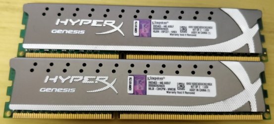

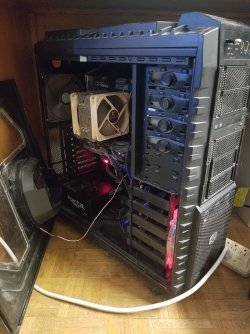

All 4 RAM slots are currently occupied by 4 X 2 GB RAM - see pic attached - Kingston HyperX Genesis
I guess I will have to sell these and get either 4 X 4 or 2 X 8 RAM sticks - not sure which is a better configuration - I do not think I will add more later.

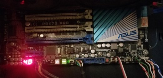

Will the SSD drive attach to the SSD Caching Connector on the MB - see picture ????

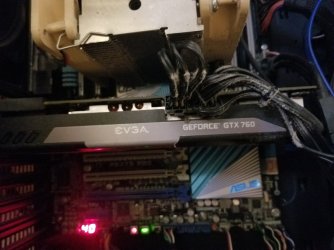

Also, is that Noctua Fan assembly too BIG - or is it OK ?

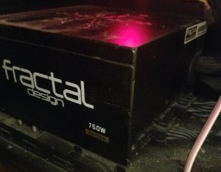

All of you have helped a great deal so I shared pictures of the PC just so you get a better feel for what it looks like
Thank you all

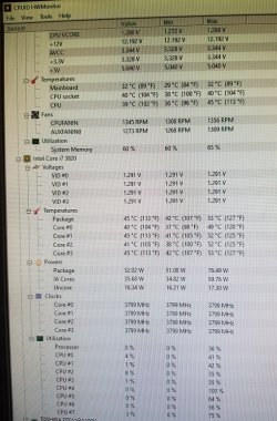

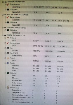

Your motherboard should have 4 empty RAM slots[8 total, do correct if incorrect] so buying 4 more 2GB DIMMs would be inexpensive and boost longevity to you system.
Alternatively you can get 4 4GB DIMMs;
