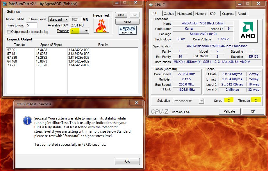

well i just did a little test to see what would happen if i forced 4 threads on my Athlon x2 7750BE vs forcing only 2 threads
4 threads
2 threads
and yes I know AMD's don't have HT but look at the 4 thread results it starts out with an hiss and a roar then slows down considerably vs the 2 thread result which stay relatively static
