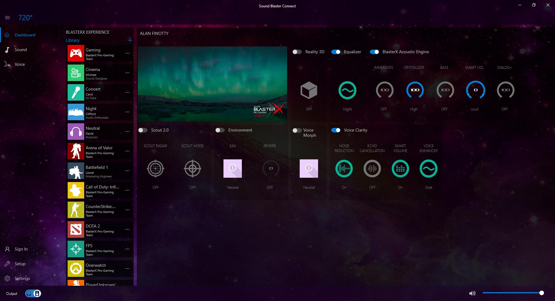

NEW REALTEK AUDIO DRIVERPACKS RELEASED
VERSION: 6.0.8769.1
INCLUDES: SOUND BLASTER CONNECT & NAHIMIC 3
EXTRAS: DOLBY DIGITAL LIVE, DTS INTERACTIVE
EDIT: COMPATIBLE ONLY WITH WINDOWS 10. MINIMUM VERSION IS 10.0.15063
LINK TO DOWNLOAD
IMAGES:
132333
132334
ENJOY!!!
IMAGES:
ENJOY!!!
