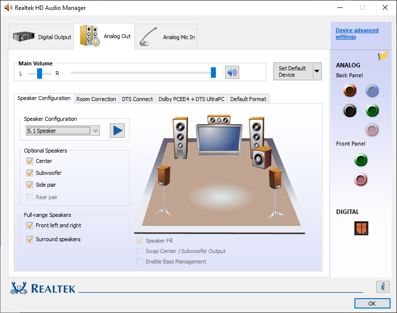

Hi Alan, so this is my problem; I have started using my custom "rtkhdaud.dat" file.
My config use PCEE4 that has extraordinary sound quality with a little help from Dolby Atmos and Sonic Studio.
Everything works perfect, sound is amazing, it also has upmix to my 5.1 analog system.
It's upmix is even better than foobar2000 "5.1 Upmix", I had been using the DSP for over 10 years but now I have ditched it.
But; when computer gets into sleep mode the AAF Optimus drive is not working.
Well it is working but there is no sound. I can see the blue bar in sound setting of Windows 10 as something playing but can't hear a thing.
No sound is being send to speakers.
This bug seems to get undone by restarting the computer after wakeup or manually disable "UAA Bus Driver" and enable again.
Sometimes it can only be reworking again by restart. UAA disable and enable is not working at those times.
Below you can find my settings and "rtkhdaud.dat" file.
Regards
Mainboard: Asus Maximus VIII Hero (Realtek ALC1150)
Speakers : Logitech x540 5.1
OS : Windows 10, version 2004

We have similar motherboards and soundchips then.
Before this Maximus VIII Hero motherboard I had used 7 years of modded driver for M4A89GTD PRO/USB3.
For my experience of modded driver usage, upmixing was never better. I prefer front L+R are copied but this is good enough. Better than Sonic Studio.
Bass if as it should be also, deep and loud but not too much. By the way good bass is handled by PCEE4 mostly, if I couldn't activated it I could say bass is not good.
