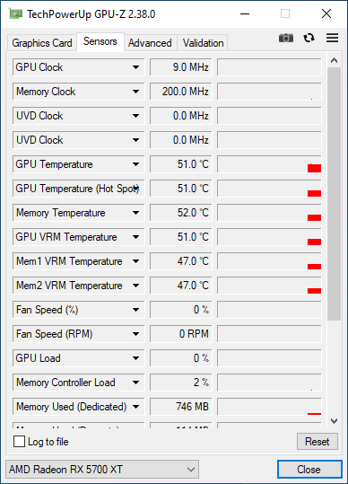

I created a custom resolution in Radeon software and used CVT Reduced Blanking at 142Hz (2560x1440) and the VRAM clock speed at idle is now 200Hz. Colour depth won't go higher than 6bpc though and idle temps have gone down about 10c.

After spending many hours with CRU, I gave up trying to fix the issue at 75hz and spent 1 minute making a Custom Resolution in Radeon Settings at 74hz with CVT and problem solved.

Try doing a custom resolution with Radeon Settings with CVT and it should your issue.

the issue we are experiencing is not considered an issue but a byproduct of using such monitors. just increase the blanking time & reduce the hz for a desired effect. or use a lower build in refresh-rate/ create on in the driver.
