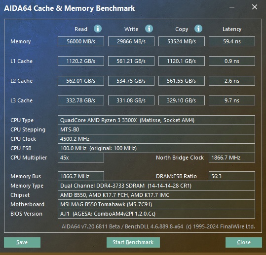

Pretty expensive used b die but honestly I am very happy with it. I probably can get a little more out of this kit but this is an awesome improvement over my old kit.
Secondary rig got a B-die upgrade. I'll see if I can get the IF stable at 1900 MHz with the newest AGESA:
getting below 60ns on zen 2 is insane. awesome you were able to pull that off
