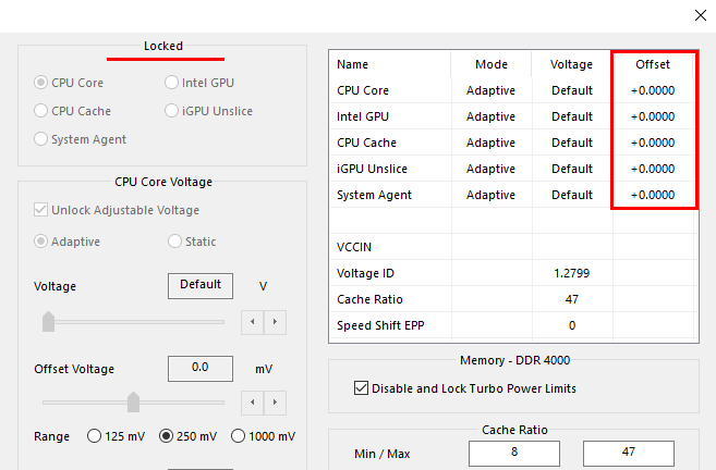

The latest version of ThrottleStop makes it easy to see when CPU voltage control is locked.
If the FIVR monitoring table is reporting +0.0000 from top to bottom in the Offset column, the voltages are locked.

I defaulted my BIOS and upgraded to the Beta and now near enough all of my FIVR view is greyed out. The only plus side I now have is that HWmonitor is registering 4.8Ghz boost clocks once more. Is there any light at the end of the tunnel or should I now admit defeat...?
Go to BIOS and reset to factory defaults (2nd option). That did the trick for me, otherwise the undervolt was locked.
