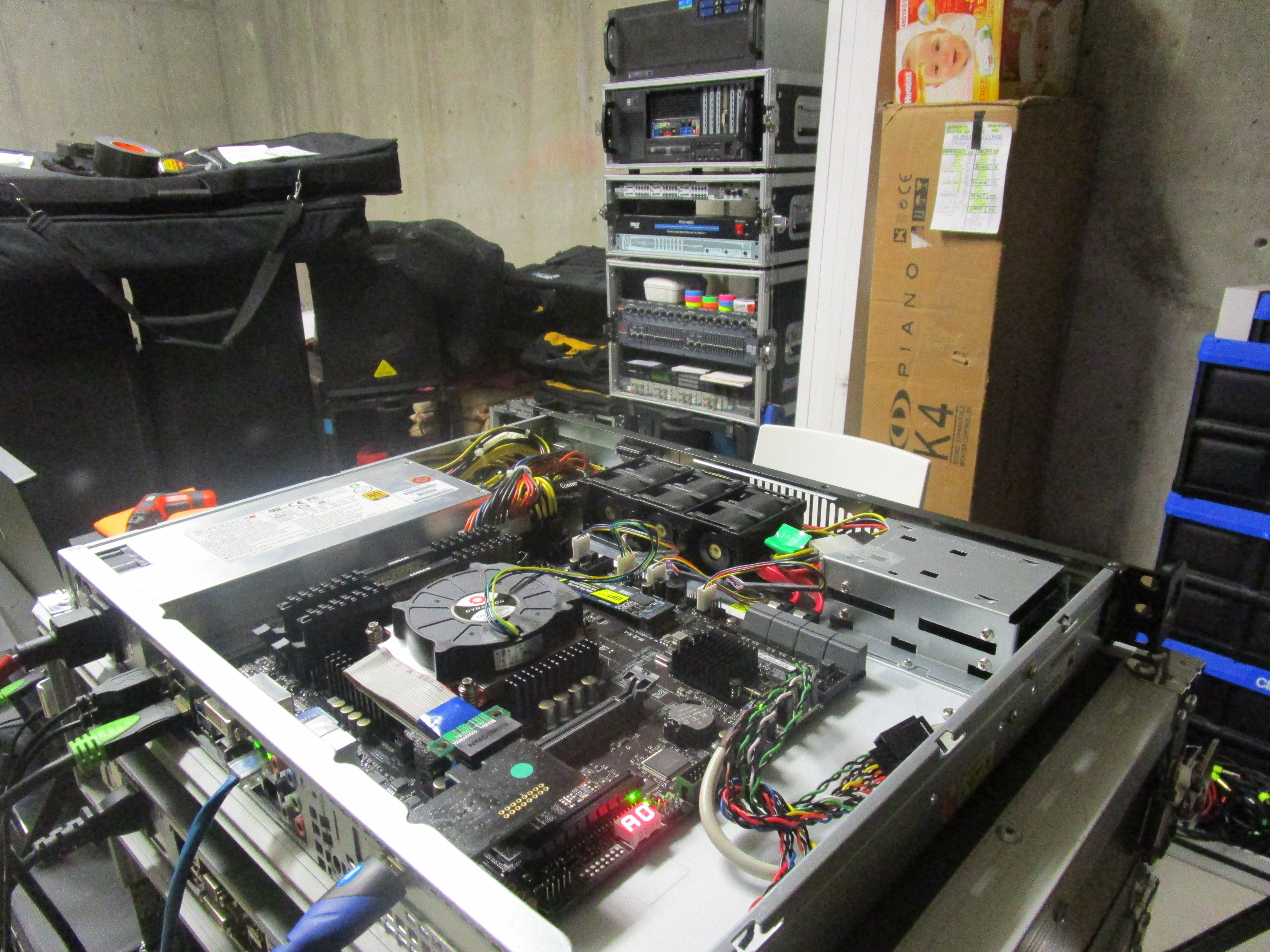

PCI-e 1X cards are the way to go with Audio/MIDI interfaces.
Streaming audio works on USB but using VSTi’s, especially if the card is placed for direct to CPU lanes is the way to achieve the lowest latency and noise free performing.
I use a 1U design I made and install the card using a Ribbon extender on 16X, a waste of lanes actually but I don’t need them since it’s a custom made VSTi PC.
