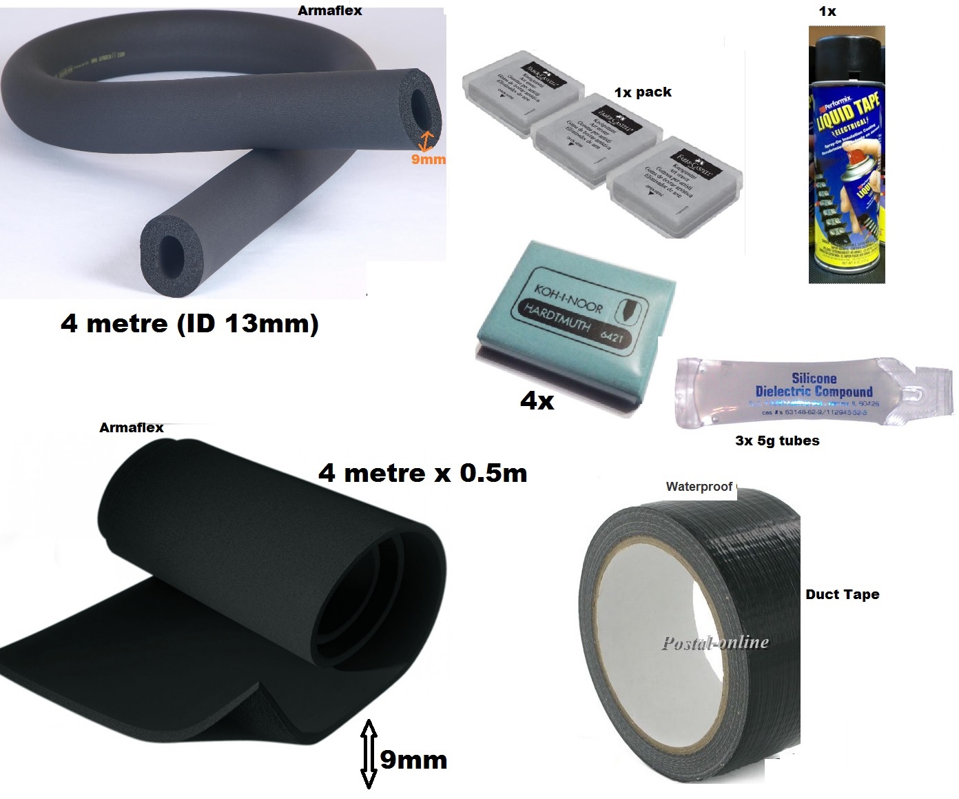

Evening lads,
Got my loop apart tonight to perform insulation prep for my subzero quest.
