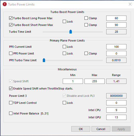

The log file shows lots and lots of EDP throttling. Your CPU is running slow.
Check to see what the PP0 Current Limit is set to and check the FIVR IccMax.
Something is not right.
Edit - Why did you set the PP0 Current Limit to 60? You used to have this set to 150.
Setting this to 60 is causing EDP throttling.
Do you remember changing this or do you have some other software on your computer changing this?
I didn't change it actually, this tpl settings are original I just checked speedshift
I didn't change it
Change PP0 Current Limit back to 150. That was working good before.
Changing the Turbo Boost Long from 45W to 60W is a good idea but you do not want to change PP0 Current to 60. Might have made a mistake by accident.
The turbo boost long power is set to 45W. That is why your CPU is throttling in Screenshot_7. Try increasing that power limit.
90W for turbo boost short power is good for performance but that is too high for your heatsink. Fix the thermal paste or lower the 90W short power limit or reduce the turbo time limit so it does not spend as much time at 90W. Default is 28 seconds. Setting this to 56 seconds is too much for your cooling. Maybe 8 seconds is OK.
