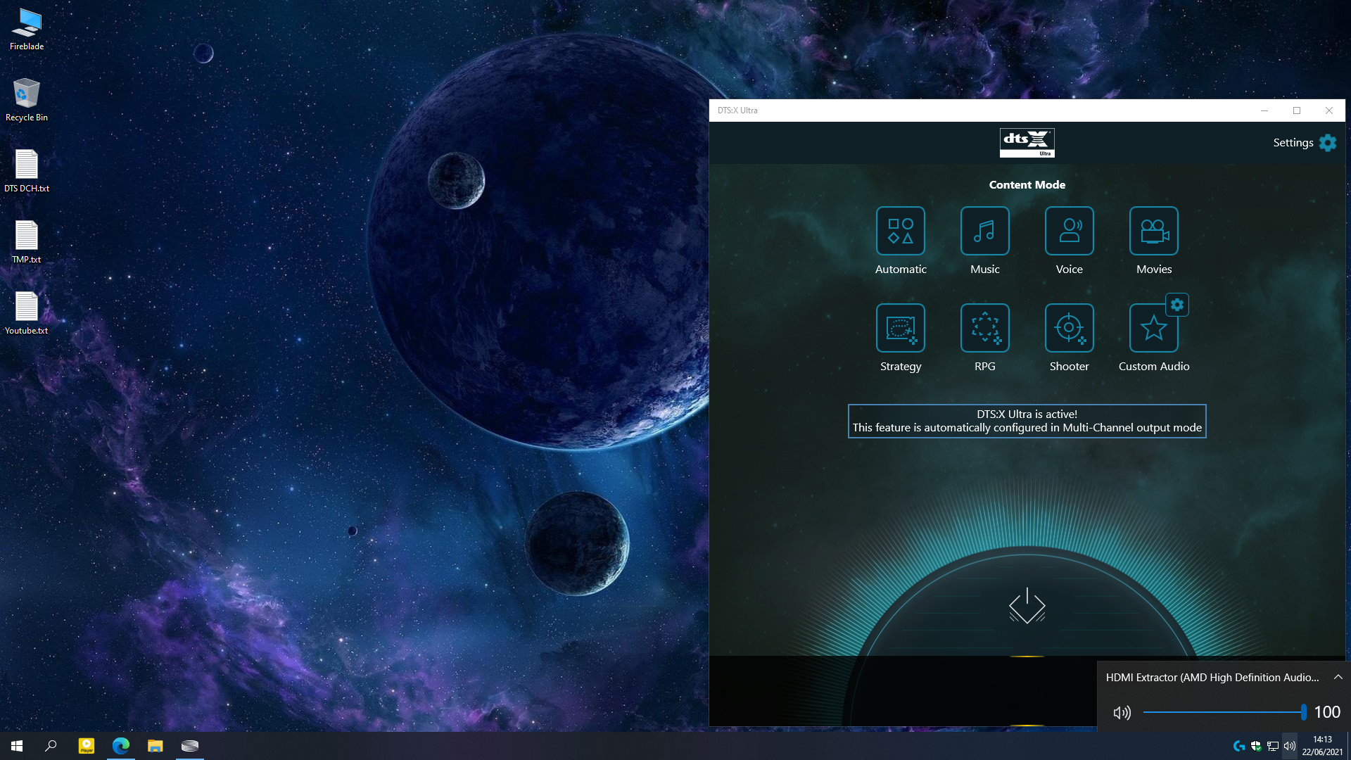

Hi Ferather i use your drivers but some reason i can not use dtx ultra i can not select spatiual sound as dtx ultra. when i select it it forces as off.
Also it says in app ''dts ultra is active! the featuers confugired auto in multichannel output mode"
I use sound bar with spdif out that would be problem. i heard ultradoes not work with spdif output?
@Northerion, the spatial sound options are for stereo (2 channel), its to mimic multichannel over stereo (2 channels).
If the DTS:X Ultra apps says "multichannel" then all is working as intended.
@Northerion, You can also set SPDIF to stereo using 'DTS Settings' and editing 'Stereo.reg' with the device GUID.
You can then use the stereo spatial modes, but the Ultra app will likely run in default.
To get control of the stereo side of the Ultra app, it requires form factor: 'Speakers' or 'Headphones'.
Without it, you can open, minimise then show the Ultra app, it will say 'Music'.
Some SPDIF devices will show 'External Speakers' in the Ultra app, if you are lucky. If so you should have control.
The alternative is to switch to 'Speakers' then back to 'SPDIF', which will carry over (temp).

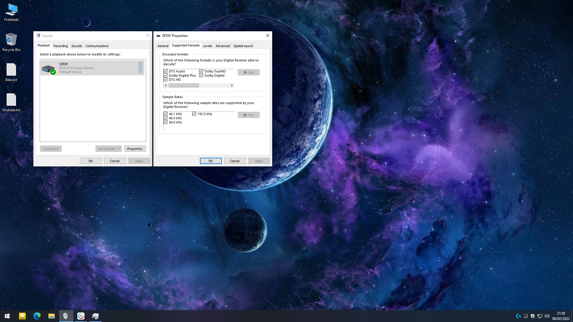

Here are some images of my older 889, where I added the extra formats to SPDIF, ticked all the boxes, then converted the form factor to HDMI.
The data converted from SPDIF to HDMI EDID, interestingly Windows did manage to report back the bit depths and channels.
Channel config option was usable, however limited to stereo due to the 2 channel transmitter (detected).
Had the transmitter been a current one, it could say something like 15+ channels.
Interestingly, a programmable SPDIF transmitter capable of 15+ (such as this one), can be handled at Windows end as HDMI.
