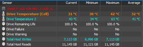

What is the drive's temp? idle/load
Try Samsung Magician software. From it you can see if the drive needs a firmware update and also what NVMe driver you are using.
You can run benchmark too...
This is HWiNFO sensors mode
howd you change the colours in HWinfo? maybve i've missed the obvious but i've never seen that before
and relevant to people still with this issue: are you running your GPU in vertical mount of a riser? I'm wondering if errors on the GPU side could slow down the NVME bandwidth
1. HWiNFO sensors window settings (gear icon) down left >> "Custom" tab
or
2. Right click on a sensor and select "Customize values..."
And you can make it like rainbow....

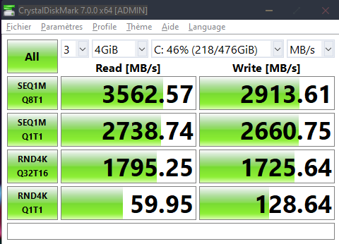

Hello everyone Have the same probleme with the Samsung MZVLB512HBJQ ( PM981a ) everything was fin and randomly it dropped his write speed, and sometimes it was like 900 Mo
I have 2 Nvme One PM981a used for the Os on an air-cooled Pci gen 3 X16 To M.2
and another 960 Evo pro plugged In the MB (Asus X370F) (for some games)
also if I switch between them I will face the same low Speed for the PM981a and, normal speed for the Evo
PS: I have another PM981a I used it to do a back up every 2 weeks if I swithe between the other PM981a same low speed
hope I was clear in my description
Ps 2.0: I have installed Samsung Magician and no firmware update for PM981a and it does not support the secure erase of Samsung
I'm actually doing a low-level format from windows and will see if there is any diffrence
