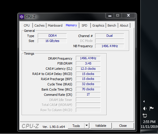

Got me some real cheap Corsair Hynix in the sig down there. I'm running Cas 12-15-15-32-70 2T. 1500+mhz 1.410v
You my friend get to go on a tweaking spree if 3200 isn't stable at 1.4000v.
EDIT:
Gotta add in the "proof" I'm doing this with Hynix Ram. It's just no good over this frequency lol.

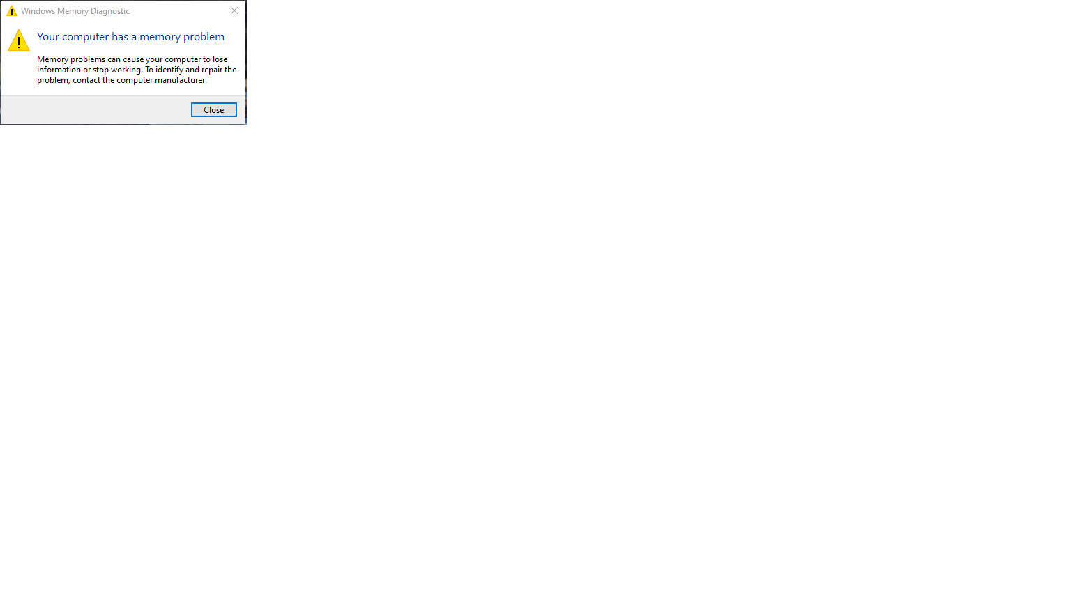

I just finished the windows memory diagnostics test and it clearly says hardware problems detected. Everything works fine, all components are properly in their places all the cables etc. Perhaps I need to reinstall the RAM again?
