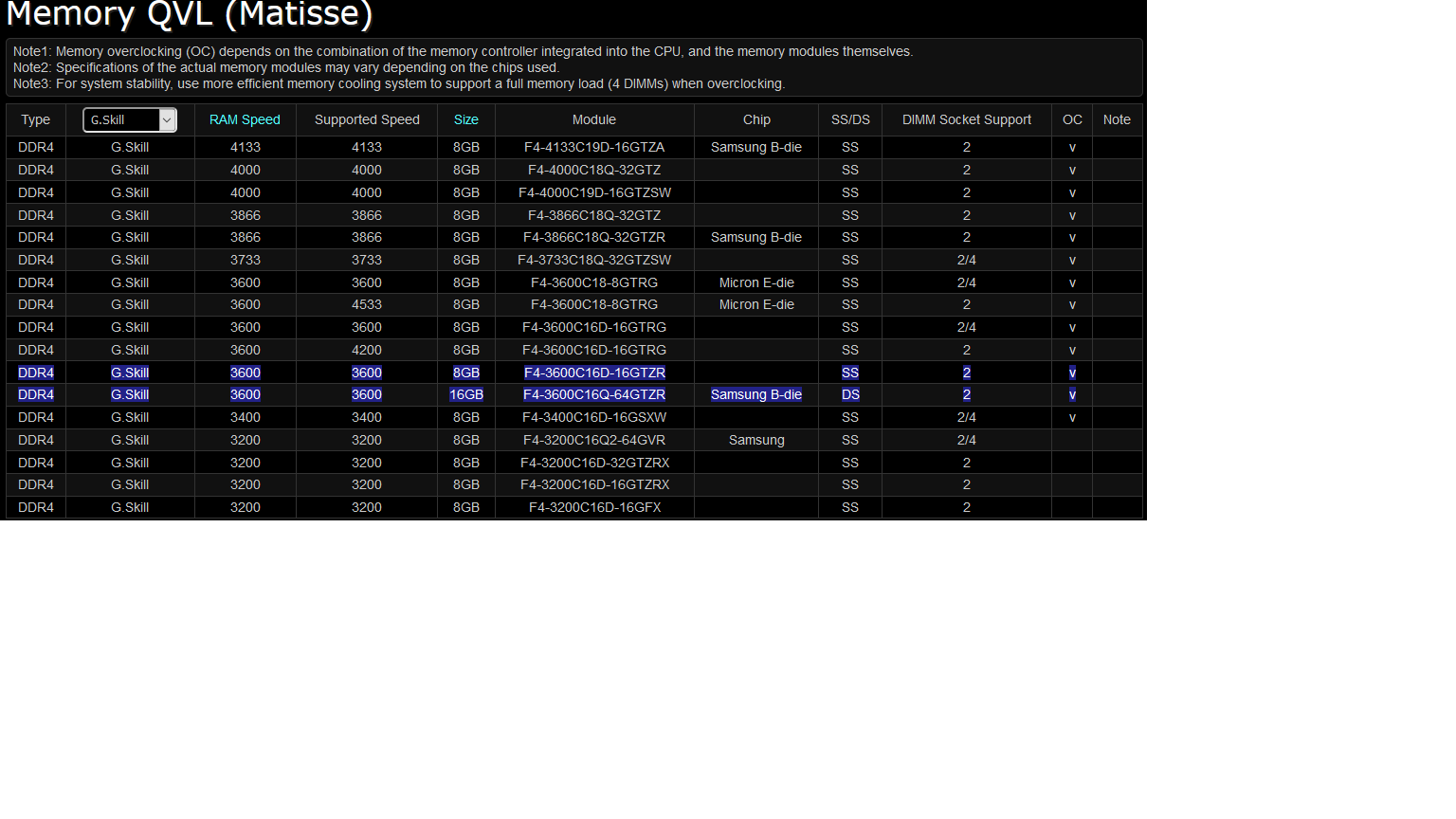

Alright, so I've checked under memory QVL (matisse) and I see the G.Skill 3600mhz 8/16GB in there. The white set of G.Skill DDR4 RAM is called G.Skill Trident Z Neo F4-3600C18D-16GTZN, but I can't find that one in the list. However, G.Skill Trident Z RGB F4-3600C16D-16GTZR is on the list, but it's the black version. I assume there is no diference between the white and the black version?
That is the best choice I think for the RAM
Thanks, I think the G.Skill series should be sufficient for my build.

Verify your motherboard qvl, if they're listed go for it.
Pretty much worthless for AsRock... You cant trust it. A lot modules not in QVL works fine and a lot that are in there dont work.
Its turns out that are copy/paste lists. There is more chance to find what works on DRAM vendor than AsRock.

I installed DRAM calculator, but I've got no idea what to do. I ran an easy test on membench and I don't know if the result is good or bad. Got any advice on this? Also, I've got memtest. How should I proceed?
Hey man. I just installed the G.Skill modules and they are looking great! I did a memory diagnostics test on Windows and this time I had no hardware problems. I've changed the XMP settings on and its running at 3600mhz and 1.35V.
If you don't care about eeking every last bit out then just set xmp and make sure fclck/if frequency is set to half of mem speed. If ram is 3600 then set infinity fabric to 1800 and call it day.

If it runs stable at 3600mhz then I'm fine with it. Alright where can I find the infinity fabric? Is that in BIOS?
You don't have to change it as 3600mhz auto sets the fabric to ideal ratio. You can check it with any diagnostics app or ryzen master.

Not sure what you're trying to accomplish by using Windows hardware diagnostics. As people have suggested, get memtest86. Put it on a USB and boot from it into Memtest. Run it continuous for anywhere between 4-8 rounds of testing. Go take a shower, watch some TV, go make yourself some food. Come back and if it's all in the clear, you're golden.
Make sure your XMP is stable at 3600/16 through Memtest before you start going off and using the calculator to tweak your timings.
