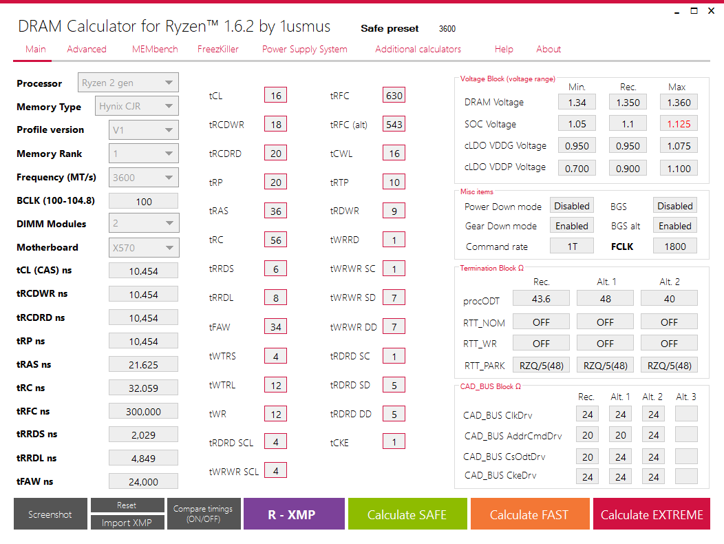

Once those parts are know, you can start keying in data into the DRAM Calculator.
As you can see, I have selected a Ryzen 2 gen, as that's Ryzen 3000, Hynix CJR memory, V1 profile, memory rank 1 (chips on only one side of the modules), the speed I want to run them at, no need to touch BCLK, the amount of modules I have (4) and the type of motherboard chipset I have (X570).
Then hit R-XMP, it allows the DRAM Calculator to read the XMP settings.
Then hit Calculate SAFE to get safe settings or FAST for faster settings. Extreme might not work.
The screenshot above has the fast setting for my RAM, but I managed to run my modules at slightly tighter timings and lower Voltages, as I'm only at 1.37V.
The key ones to change are tCL (CAS), tRCDWR, tRCDRD, tRP, TRAS, tRC and tRFC. Apart from tRFC, all the other ones should be in order under advanced memory settings or something similar in your UEFI. The settings might be called something slightly different though.
Obviously, going beyond 3600MHz for the memory clock, you'd have to set the FCLK and Infinity Fabric speeds manually, but I doubt that's something you'll be playing with for now.
Just try lowering the mentioned settings to whatever the DRAM Calculator suggests on fast settings, if that's an option with your modules.
Normally you can still keep XMP enabled and then just tweak the settings.

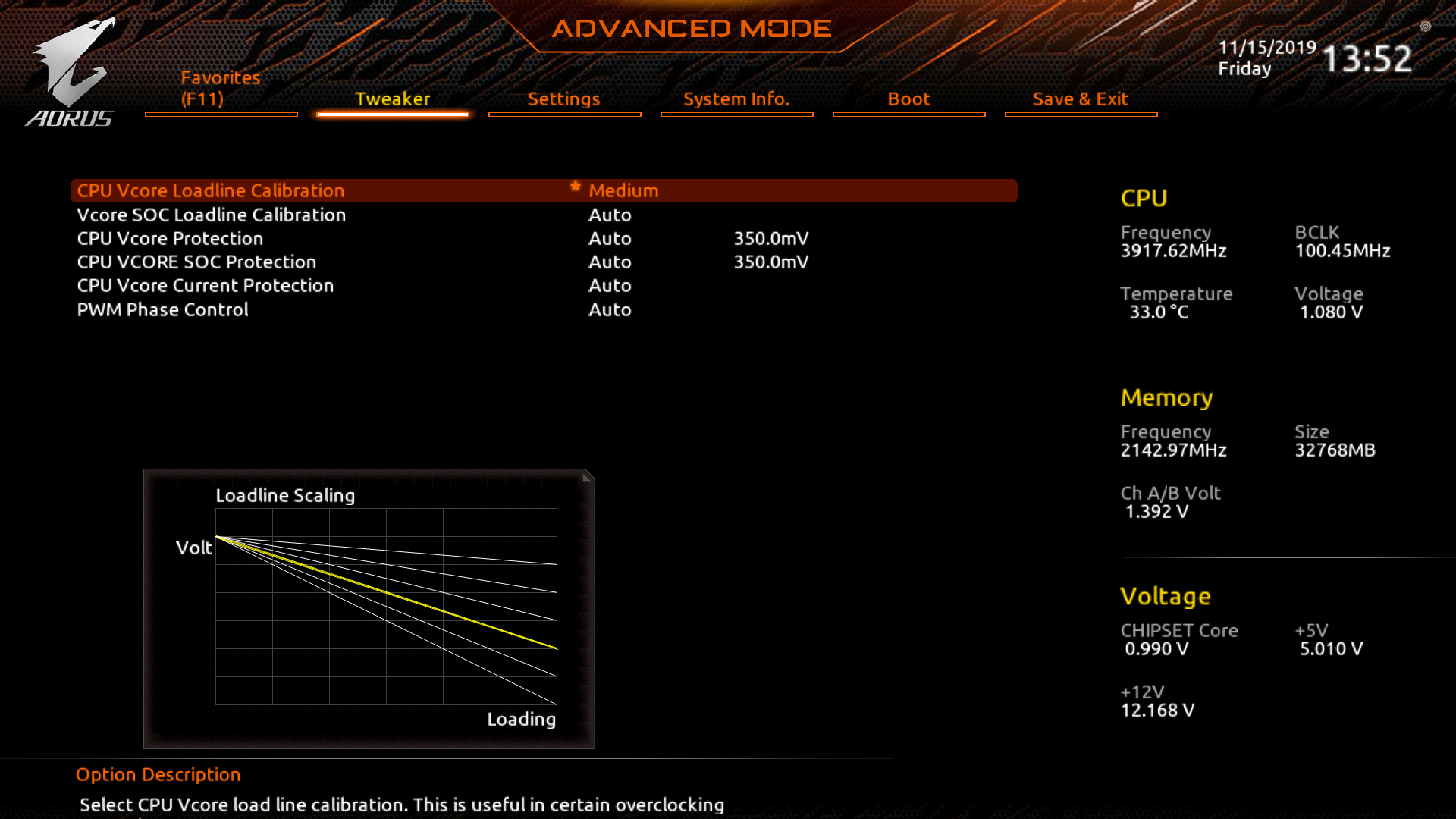

You might also want to take a look at procODT, as it can help with stability. Likewise with Loadline calibration. That said, these should be fine on auto with your RAM at 3600MHz.
Some screenshots from my UEFI with the settings I've changed.
And the end result.
And the end result.

I did the typhoon result and entered the information afterwards in DRAM calculator on SAFE and FAST. Here are the results. What do you guys think? I have been running XMP for a couple of days and have had no issues with gaming or BSOD's.

I would look at setting the fast settings for sure, as that's a huge latency reduction. Not sure why G.Skill sells this RAM at such high latencies for Ryzen, but it's easy to solve.
Also, it might be worth looking if you get something decent at 3800MHz, as at least in theory, you should be able to run your RAM at the same speed as me. That said, the Infinity Fabric speed of your CPU might not go to 1900MHz, but 3733MHz is also an option you can test if 3800MHz doesn't work.
