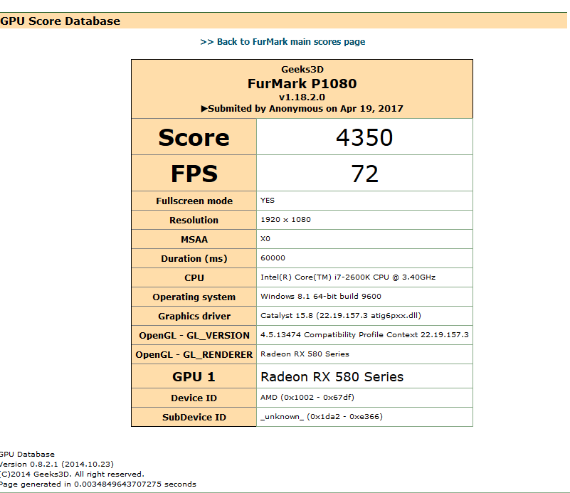

xfx rx480 8gb flashed to saphire rx580
As for the drivers they were a little weird to install. No official release for windows 8.1 so I tried a windows 7 and 10 from the AMD site. None of them would install. So I manually installed the drivers through device manager and got the drivers working but, the newer Catalyst wouldn't install, so I ran Crimson 17.2.1 Feb22 and it seems to work fine.
Thanks! Its been a long night, but I still got some more testing to do, but hopefully its all worth it.
This should work fine. Just for other people trying to copy this. TonybonJoby is lucky that his card the RX 480 RS uses the NCP81022 voltage controller that the RX 580 Nitro+ does. Most RX 480s run the IR 3567B and flashing those with an NCP81022 BIOS might not work at all.
As for what it did to the clocks and temperatures. Anything under 85C is fine. 1.22V is safe for daily use. The gains the RX 580 BIOS caused are basically only because the 580 is a 480 with a higher power limit and voltage set in the BIOS. I can't see this causing major issues in the long term beyond what a regular OC on an RX 480 could cause. Also the more refined low power states are IMO a nice benefit for daily usage.

Here is the performance that I am getting with Benchmark. Which is surprising given the fact that compared to true rx580 it is out-performing them as well.
I increased the Memory speed to 2100 this time for the test. At 2000 I was getting 78.8%
Here are my msi afterburner settings.

I would suspect the RX 580 would be the same as the RX 480 in the fact that the 480 was very much memory bandwidth starved 2150 based on extensive testing was the sweet spot vs power over at overclock.net Also using the 1750 memory strap in place of the 2000 memory strap yielded better results generally...some mixed straps also work rather well.

Alright so ran Furmark on the 2100 setup, started to see some artifacting and then display driver crashed. Toned down to 2050, same results but just a little longer to get there. So most stable settings for memory is 2000 Mhz.
I would not run Furmark or the OCCT from what Powercolor advised when they released the Unlock 480 bios to Red Devil owners.
