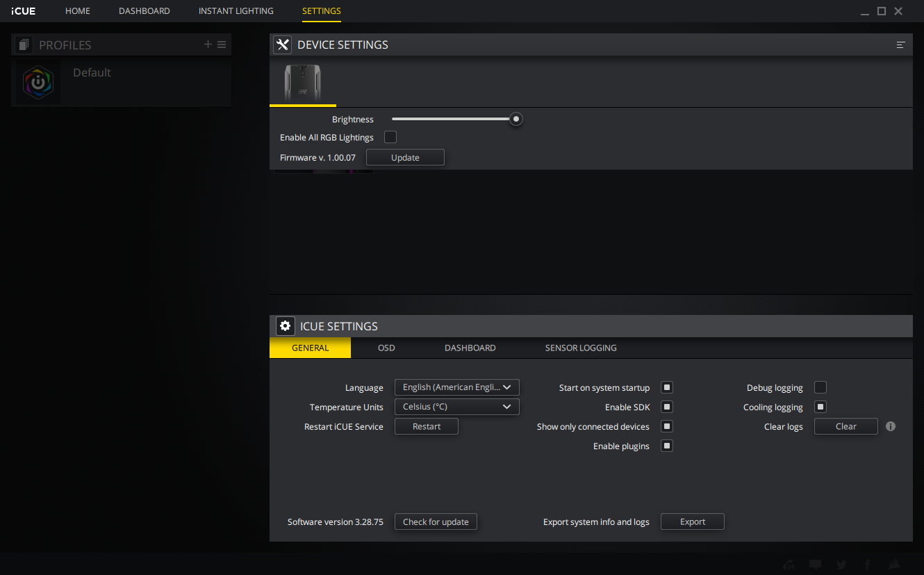

I'm aware of those Firmware update settings in iCUE, but aren't those firmware updates for the devices themselves? For example, I have lightning node pro, lightning node pro and commander pro. Actually since the new win install, iCUE thinks I have HYDRO X as well though which I don't. I did try to update it for all 3 but it always said I have the latest version installed

Oh yea if you didn't know HWiNFO64 and iCue don't play well together. Just don't run both at the same time that's all, in my case all the commander pro sensors stop working. HWiNFO64 can read fan and temp sensors from Commander Pro even after you close iCue or didn't start iCue on login.
Jep I know that, same here. Also Ryzen Master criples iCUE hehe
On my Ryzen system I use icue only and do all tinkering in the bios.... 0 issues on either Asus hero or Gigabyte master motherboards.
