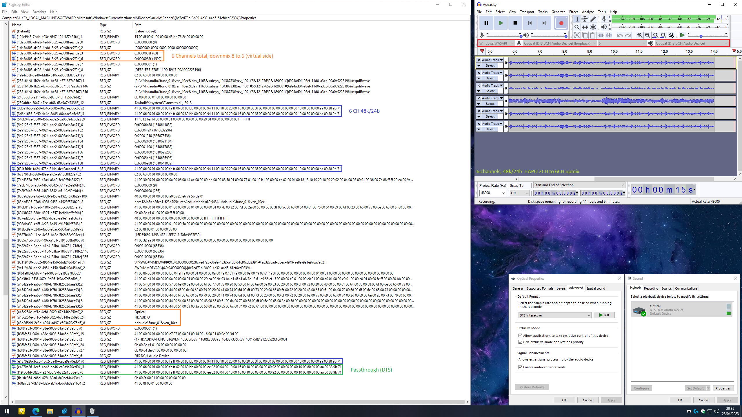

@GavRon, let me know if this works, this is 6 channel SPDIF (HT), I have set it up so you can edit then restore the data. Alan can also use this method for offload setups.
Open 'Device Manager', and select 'Audio inputs and outputs', then double click SPDIF (Optical in my case), 'Details' then 'Device instance path'.
Right click and copy, edit the supplied .reg, and replace {-DEVICE-ID-} with the copied data, removing all but the {GUID} part, disable SPDIF in playback, then restore.
You should probably reboot, but try before hand.
Normally the Realtek API registration will cause the APO-Driver to setup SPDIF with a 6 channel processing line (old method).
