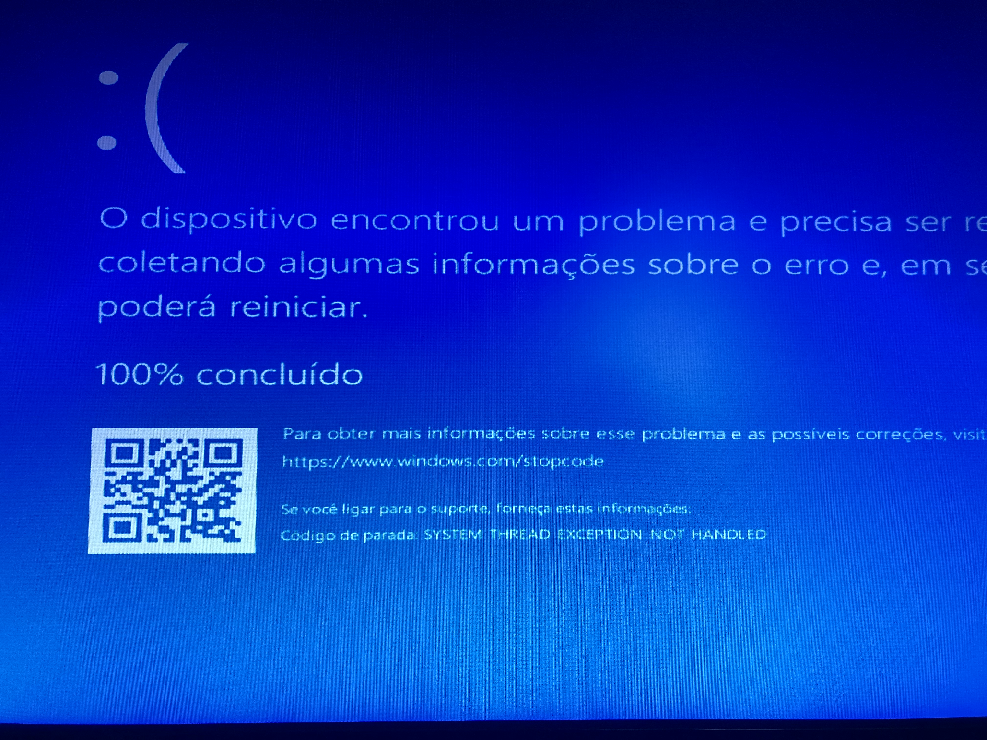

one problem at a time, that sonar software shipped with motherboards. it's a way of asking you if there is anything running that might affect things, because without actually being there and seeing the system i cant ask every question - its upto you to provide all the information you can
The BSOD we can solve over time, take a photo of the error when it crashes

One of the BSOD messages right after I started the PC. Also I’m having a problem that is really weird, every time I try to turn off or restart my computer, the screen goes black like if it was off, but all the RGBs on the PC are on, such as the fans that still running. And I received 3 different BSOD codes. Also about this problem I uninstalled the AI Suite 3 and seems to be fixed.

You may be right that it was AI suite (this is the sort of program you should have said was running in the background) (the workaround is to disable virtualisation support of the CPU, apparently)
AI suite stopped the BSODS? AI suite is a good example of something you should have said was installed, as its an overclcocking tool
