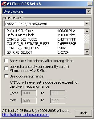

my data
I sure hope I can turn this one into a monster ;)
Sapphire RADEON X800GTO FireBlade Edition R423
It has the "F"'s but I dont think it's a gto2 though.... :confused:
Would be real nice if you could come to the rescue here W1zzard :)

H2O your fuses show that you will NOT have 16 pipes even flashing the BIOS. Sorry to say that but it is true :shadedshu . You can change the number of the active pipes in your original BIOS and to re-flash it but it won't help you.

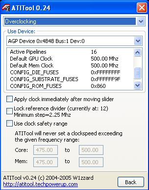

my vard (video card, my abbreviation :) ) is HIS X800GT IceQ Turbo, 2.0ns samsung,i'm not sure whether it has R423 or R480
in ATItool shows
CONFIG_DIE_FUSES 0XFFFF9FFF
CONFIG_SUBSTRATE_FUSES 0XFFFFFF9D
CONFIG_ROM_FUSES 0X862
GB_PIPE_SELECT 0X19940
can i mod it to 12 pipeline..

Hi
My card MSI Rx800SE
CONFIG_DIE_FUSES 0xFFF36FFF
CONFIG_SUBSTRATE_FUSES 0xFFFFFE9D
CONFIG_ROM_FUSES 0x22
GB_PIPE_SELECT 0x25650
