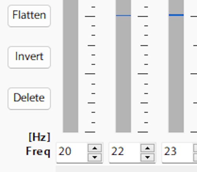

@Ferather By any chance, is there a way to invert an equalizer config in EQ apo ? I'm trying to do so with the frequency response of a pair of headphones to see how it ends.

I don't think there is an option to invert, you will have to do it manually.

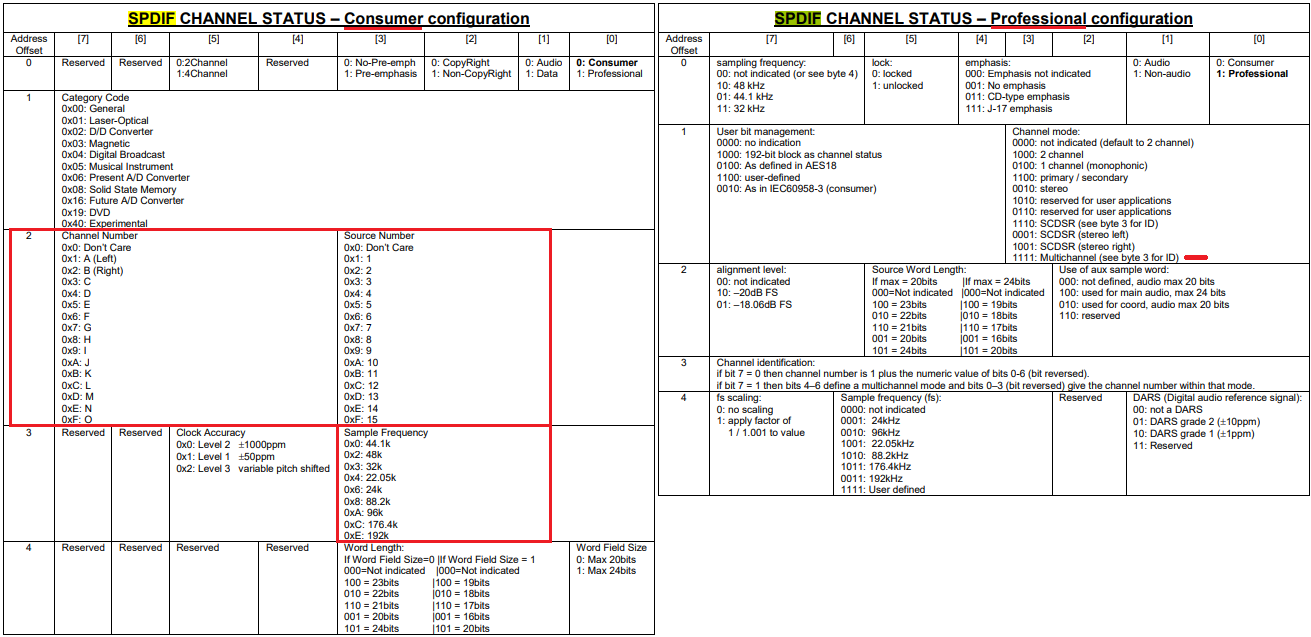

@Lucky8, SPDIF does not specify a bandwidth limit, also wiki is out of date and still references the legacy standard, like referencing HDMI 1.0, even though we are on 2.1+.
All digital transmission can get clock jitter, you can get clock jitter on SPDIF, HDMI, other. HDA (this includes GPUs) can only do ~37 mbps.
IEC 60958-5:2021 | Standard 15+ Channel SPDIF (AES18) | 15+ Channel SPDIF Transmitter | 8 Channel 192k SPDIF Receiver
2m Toslink (SPDIF) Male Black Cable - Blake UK (All formats, 7.1 PCM)
8 x 192k @ 24b = ~37mbps. Stop reading about legacy SPDIF :)
Also, I am not sure why an AVR with a Class-D amplifier (that has a digital input) is using a DAC and then the analogue input.

Hey, I found it the invert button!
I just had to select the already present EQ of my headphones and choose to create a custom one ( which use is as a base ) and then there are those options

What is the max bandwidth for SPDIF? If people are so confident it doesn't have enough, then what is it? < Note its not 1983.
Also try and get more than 8 channels out of HDMI, even though the EDID will only go up to 8, same with Windows.
If we re-iterate over the ALC HDA chip, we can see there is almost no parts to SPDIF in/out, a transmitter/receiver and module.
The 'HD Audio Interface' listed on the left is HDA, with its maximum ~37 mbps per stream in/out.
125mbps out with the current SPDIF spec, but only capable of ~37mbps input from HDA.
Realtek USB however, another kettle of fish. Same parts, you will get the full 125 mpbs, per stream.
If you actually search Google, almost everything you will find will be referencing the 1983 spec @ 1.5 mbps.
Also note that they actually refer to the TOSLink module, not SPDIF its self, see below.
A Realtek is capable of 2 x 192k which if I remember correctly its just below 10 mbps.
