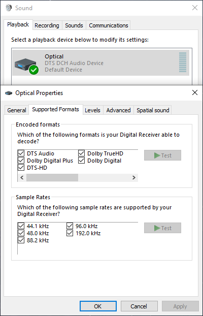

wondering how these drivers act with a optical usb adapter tested it out and it did work but my usb adapter has both dolby digital aswell as dts support tryed overwatch 2 with this adapter cause i diddnt know if live encodeing would still work over pure optical and with the fxsound fix it worked i was shocked so dose it treat the signle the exact same from when i was useing my hdmi audio extractor ?
Yes, with my extractor I am able to add whatever APO's to it (GPU is HDA), including encoders. HDMI audio easily converts to TOSLink out, at the computer end, the endpoint will be HDMI.
I modified the EDID for my unit, to add extra formats. The unit I am using is specified capable of multichannel LPCM via TOSLink, 6 channels on the spec sheet.
I had a conversation with the manufacturer, they actually re-tested the unit and also confirmed it will do 8 channels over TOSLink.
The extractor these days just sits around growing dust, since I got the S1220A, I don't bother with it.

is this the correct form i need to download to get dolby digital bitstreaming back out of a usb to optical adapter
Is this working correctly?
I've deleted my original realtek drivers + Sonic Studio 3. Then used DDU to unistall realtek drivers fully.
Installed AAF as admin.
All of the buttons in this panel give me errors.
