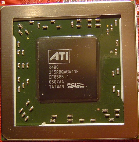

Another powercolor x800GT 256MB...
Thanks guys for your effort to try understand the pipes unlock mechanism.
If i can help you just say it.
Neocal.

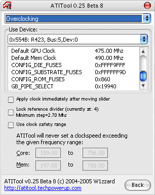

Here is a pic of my card, any chance of mod the videocard??
ShadowFlare said:
It's not really that useful, since you can get the same effect without hex editing by just flashing the bios using methods that have been posted. Someone could ask the author of RaBiT to add that feature, though. That would make it easy for others to do the mod on the number of pixel pipelines. Especially since just modifying only that value is not all that should be done; there are CRC values, checksums, or something similar that need to be changed, too. I have found that if you modify that value, then open and save the bios in RaBiT, it will fix those things, though.
There is one reason that it was useful for me, though. By modifying that I was able to reduce the pipelines on my card so I could test it at X800 GT speeds.
but could be that be a safer way ,respect to a bios flash?
Speaking for me:
i don Have a pci videocard,and i could'nt resolve a bad bios -flash,
that's why i'm not tryng,though deep tempted.
if making that manually ,would be it safer ,what ya think?
